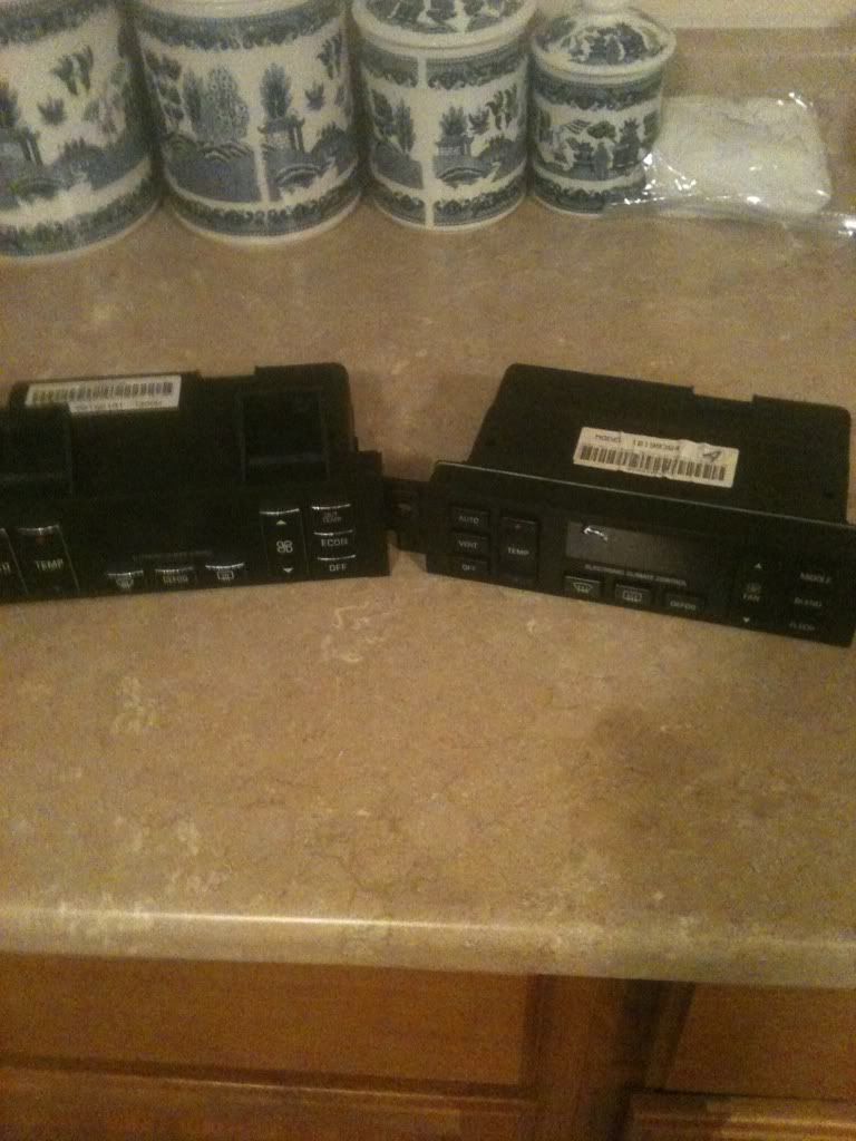

I don't know about anyone else's feelings but the fleetwood's heater controls are the worst design ever!
I'm gonna have to do a flush I think because it takes forever to get hot air, but that's not even the crappy part....
The hot air only seems to come from the floor ducts or the defrost vent. I have yet to see any air blow out of the front vents unless the a/c is going and you set the thermostat to 65* or below. (maybe the ones I've owned were broken???)
Soooo I decided to swap a climate control from a roadmaster in with a little modification and I now can get hot air to blow (and hard!!!) from the front vents.
Not only that but it's retained the code reader and all other functions! EVERYTHING WORKS!
It's dark outside (and even darker inside with that lovely black leather Twisted Evil ) so pics will be posted tomorrow, but here's a few I tried to snap with the phone.
Fleetwood Brougham's climate controls SUCK! Fbba339a
Fleetwood Brougham's climate controls SUCK! 6ae3819b

I have a Buick climate control in my Fleetwood.

Did you put it there or was it a previous mod?
I knew ppl swapped them into the SS but not fleetwood. Best mod to the car so far!!!!

It was already in there. But had it not have been I would have done the same. It's not as easy to swap into a manual cc car as it is in the fleetwood which I'm sure you know. I'd like to do an auto climate control swap in my Caprice one day. I have the control head but that's about it.

Yup. Simple swap. Put in a Buick one. I absolutely HATE the climate (non)controls in the Fleetwoods!!!!

Wow, I thought the controls were the same aside from the chrome trim on the buttons.
Might be a stupid question but here goes...
They look the same to me except for that chrome. Obviously I've never owned one so I don't know what they act like but why do you all hate them so much? I need some clarity guys! Thanks Wink

..... Im on my 5th FWB and every one has had the same issue. Stoopid design indeed. Surprised
You only feel air moving when the speed is set to high, and you only feel air moving from the windshield vents and below the dash. Yes, there are directional controls on the dash vents, but they do nothing. So in the winter time even thou your glass is defrosted, your leather seats and steering wheel stay ice cold santa

Rm controls was one of the first mods I did in my fleetwood. Much better control over where the climet control goes.

I've put the RM controls in all of my FW's. Just did the one in my stepfathers black Fleetwood yesterday. Best mod!

Yeah, my big problem with the Caddy controls is that you cannot control where the airflow is directed. Heat comes out the floor only. Defrost comes out the windshield only. AC comes out the dash vents only. Defog at least allows windshield and floor vents at the same time.
But the Buick... You want heat out the dash vents? Yeah. We got a button for that. AC out the floor? No problem! Smile
It's all about control. Wink
It has nothing to do with fan speeds or air velocity, Matt. I think something may have been lost in the translation. Wink
