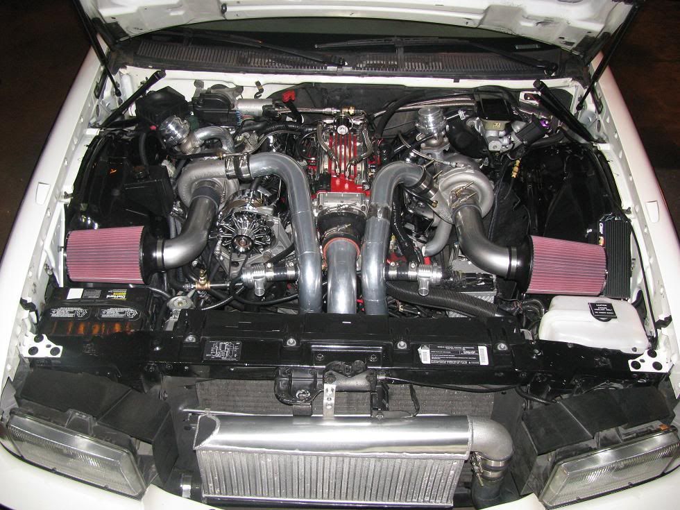

http://www.impalassforum.com/vBulletin/showthread.php?t=258516
Why did I not know about this?!?!?!?!?!?
Shocked
*thud*
PostSubject: Re: has anyone here twin turboed a caprice?   Mon Oct 17, 2011 8:35 pm

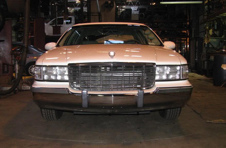

Bill is like "Oh! That is how the piping should be run!" Razz
That Fleetwood is one sweet sleeper. cheers
PostSubject: Re: has anyone here twin turboed a caprice?   Mon Oct 17, 2011 10:00 pm
Uh oh, I think I shat myself.

PostSubject: Re: has anyone here twin turboed a caprice?   Mon Oct 17, 2011 11:00 pm
THe only problem i see with that setup is the tubes run under the radiator support and my car sits little lower then that one. I thinks they would be to close to the ground.

Something like that... Wink
Had I not bought that phucking piece of chit subaru, the marshmallow'd have a big honking single turbo and all forged internals right now...
