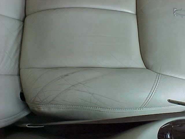

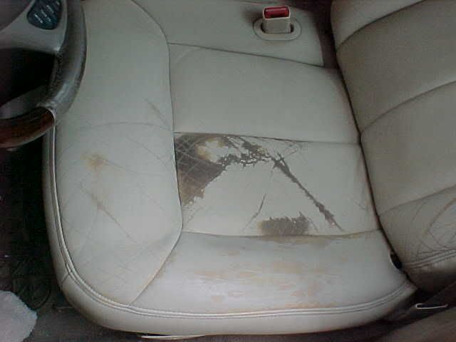

The seats on mommy's fancy ford were showing their age and UV damage,. I looked around for leather rejuvenating products and read up about this company,.
leatherique

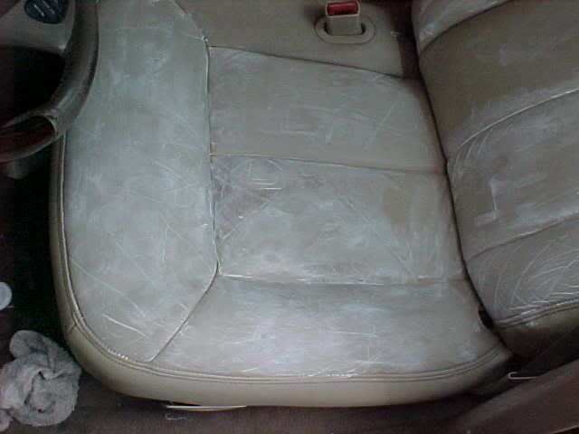

I ordered some of the product,. and for the past week i,ve been redoing the seat,.(just 1 for an experiment,)
First i slathered on the rejuenating oil,. and the leather slurped it up really quick,. it,s best to leave the car out in the hot sun,. after a couple of coatings,. i cleaned the oil and muck off the seats,. a huge difference in itself,.

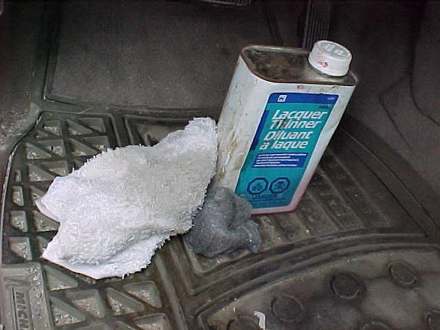

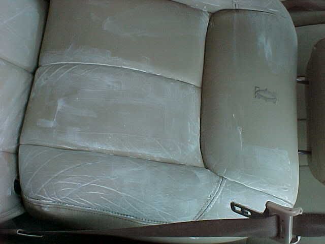

I then used laquer thinners and removed a bunch of the badly cracked dye,and filled other cracks that weren't so deep,..

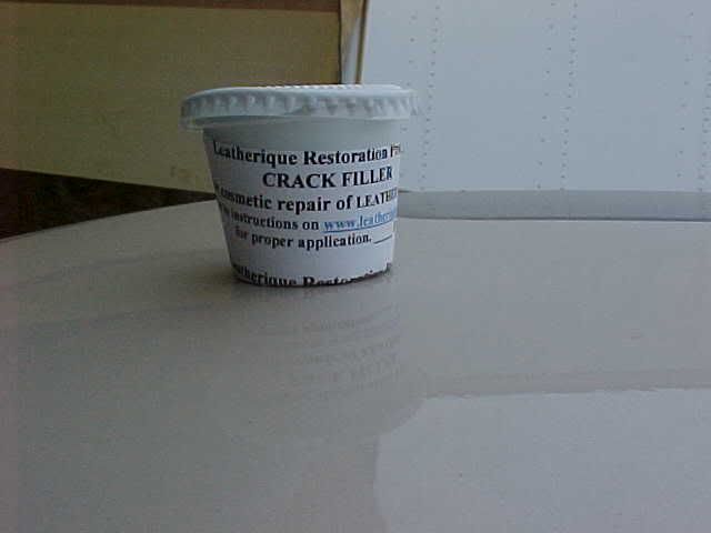

spread on a really thin coat of crack filler and let it dry,. i used a piece of laminated paper so it bent and molded very nicely to the seat,.
i was amazed at how easy it is to remove the dye,.and just how the cracks are in the dye not the leather,.

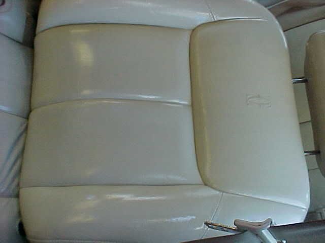

i thnned out the dye and did 2 light coats with a really expensive soft brush,.
let the pictures speak for the job,..

after they dry completely a nice buff and i think they will be awesome,
most all of the cracks including the tiny spider web ones have all but disappeared,.
i,m really pleased as mommy's fancy ford is a nice car,. and this will make it nicer still,.

go to the web site and see the customer gallery's,. the crack filler stays supple,.

i did the impala ss seats in the black wagon with SEM 4790? burgundy maple wahtever,.,. they are cracked pretty good after nearly 3 yrs,.
The laquer thinner doesn't hurt the leather,. it just removes the dye,and evaporates real quick( need both front windows down tho as i caught wicked dizzy spells and a head ache after),.. i used terry towel rags and turned them over constantly, as it removed the dye
I was just outside,. the dye has dried to the touch,.and i can squash the leather by hand and it seems fine,.

I actually bought this restoration stuff a year ago,. the crack filler had dried out,. i called them and they sent me a new pot absolutley free and i got it in 3 days,
pretty decent customer service and i caused the problem by not using the stuff when i got it,.i paid around $100.00 from the canadian distributor,.
i got a bottle of leather oil,. leather cleaner, custom matched dye, prepping agent, crack filler, 2 paint brushes,
