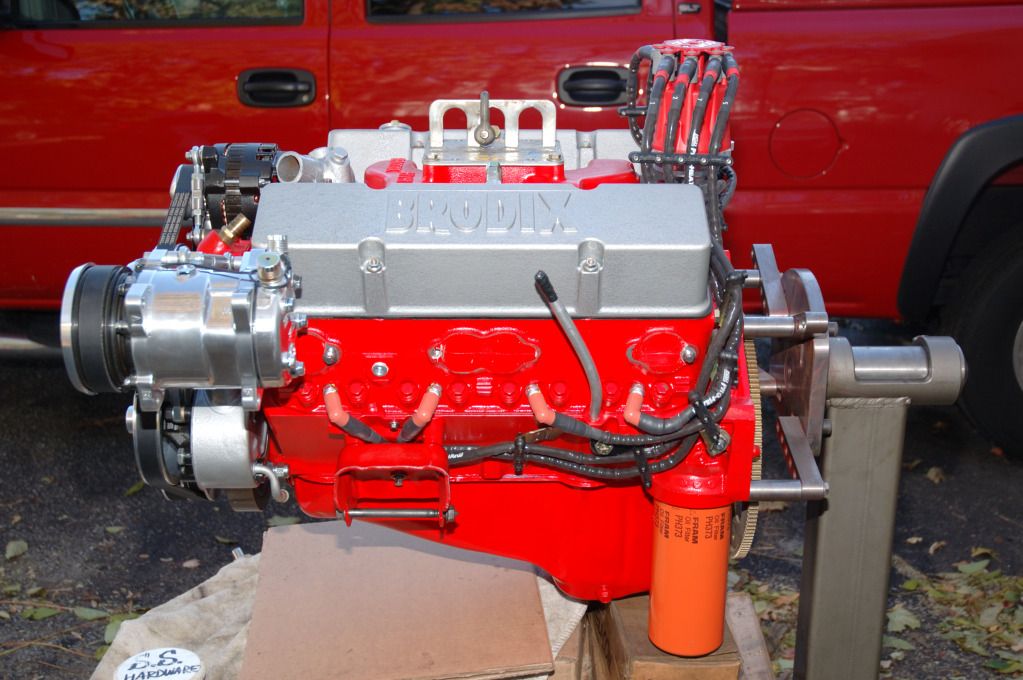

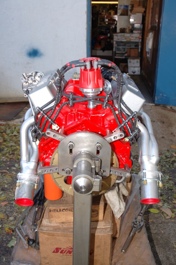

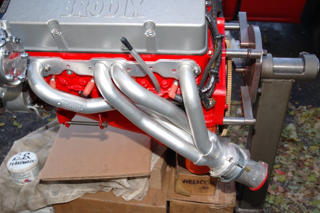

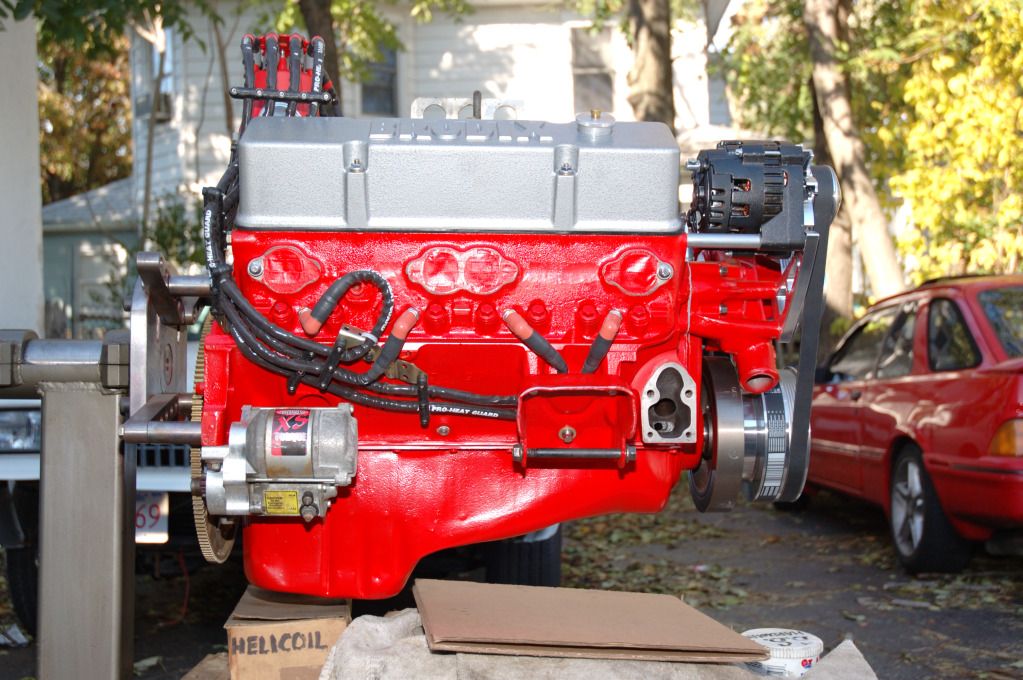

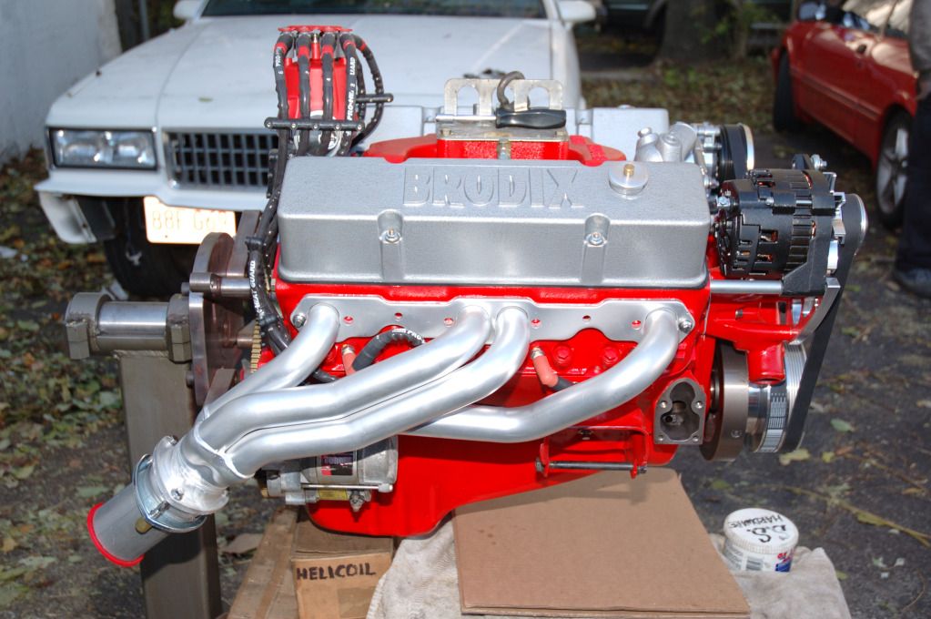

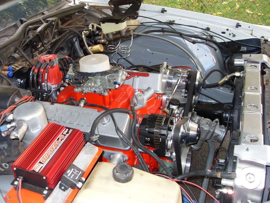

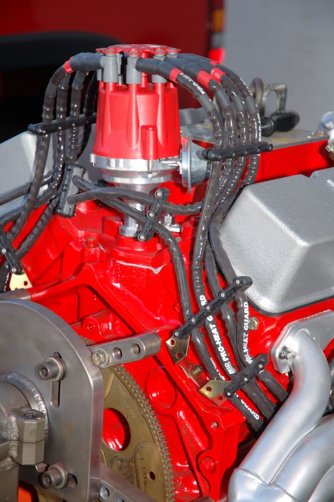

I am not sure the OEM or Delco wires installed 15 yrs ago are still USA made or as good & reliable.
But, whenever I've figured out a good solution to a tough problem that can be implemented with superior USA sourced parts and materials, I stay with that.
This approach is not for everybody, but I happen to agree with the idea that longevity & reliability far outweigh saving $75. (MSD 32159 $128.xx!)
http://www.summitracing.com/parts/MSD-32159/
So, for anyone who believes that the extra care taken building the best wire set possible will help keep you from sitting waiting for a tow truck on the side of the road one miserable night, while contemplating why it seemed sensible two years ago to save a few dollars in ignition parts, well anyway, this is how I did my 88 Boxy,,,
MSD 8.5 black, with pro-heat-guard, shrink "#"sleeves, MSD loom kit (modified), orange MSD tape sealed under the black HD heat shrink sleeves.
Obviously I expected not to have any problems with this set, because I chose to run them trapped behind my motor-mount clam-shells.
I made up this set after the last dyno pull & engine painting. I had the distributor adjusted just right so I could get the wires to be routed neatly & evenly.
Yes, Taylors I've had DO burn easily, being so fat and soft.
This same approach can be used to make your LT1 wire set, building them yourself insures a perfect fit!
