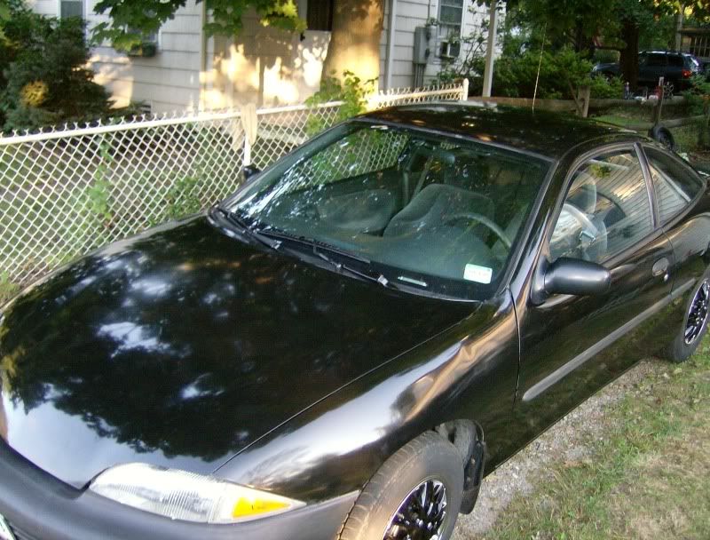

http://monumenticus.imgur.com/rollon_paint_job#BRuqf
Came out pretty nice. I read a few threads a long time ago where people were using Tremclad (like Canadian Rustoleum I guess) doing it the same way.

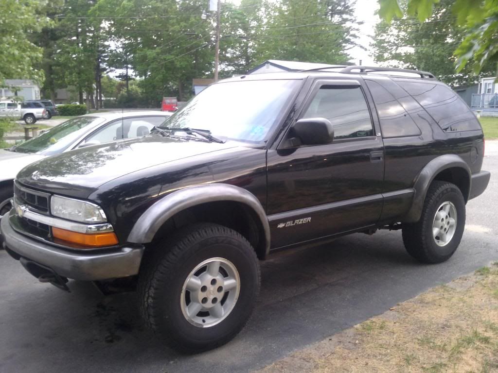

This reminds me. I have to get some paint and spray the blazer satin black.
Roll-on Rustoleum paint job photo essay SSPX0541

heres what i stated with
Roll-on Rustoleum paint job photo essay HPIM0664
Roll-on Rustoleum paint job photo essay HPIM0667
after a quick sanding
Roll-on Rustoleum paint job photo essay HPIM0684
Roll-on Rustoleum paint job photo essay HPIM0678
the first 3 coats of paint
Roll-on Rustoleum paint job photo essay HPIM0696
Roll-on Rustoleum paint job photo essay HPIM0697
Roll-on Rustoleum paint job photo essay HPIM0702
resanded with 800 afterward i did another 3 coats of black which turned out like the above pics.
Roll-on Rustoleum paint job photo essay HPIM0706
today i sanded some of it down with 1000, i tried using an orbital polisher but didnt seem to work well, so i used my angle polisher, problem there was i had only polishing pads, it was working but not good, i jury rigged a white buffing pad to it, ah that did the trick, so i stopped cause i couldnt find any 7 in buffing pads and it was late so ill find them monday, but the small spot i did i was impressed looks like it might work ..lol

and this is with a roller?
can't wait to see how this works. I've seen it before, but I've heard it's a pain in the ass to do (though not as bad as spraying with a can
Posts : 221
Join date : 2009-03-05
Roll-on Rustoleum paint job photo essay Empty
PostSubject: Re: Roll-on Rustoleum paint job photo essay   Roll-on Rustoleum paint job photo essay EmptyMon Aug 22, 2011 6:54 pm
yeah a royal pia..never do it again... but cant go wrong with about $30 investment, time consuming yes, could of done a better prep .. yes.. but its a beater so i didnt care, im looking for some 7" buffing pads, not a damn store around here has them, they got polishing pads but no buffing, i can get from grainger but i have a few more places to call will post when done Smile
Looks a hell of a lot better than peeling clear coat. And Holy crap! I'm not the only one from CT here!!!

got the pads from grainger, did the trick,started to but some wax on it but got to dark, the mosquito were eating me alive,hopefully weather will hold out tomorrow, 95brmw what part of ct,

well finally got around to finishing her off got her waxed up and tape is off, threw some new wheel covers on
so went from this
Roll-on Rustoleum paint job photo essay HPIM0665
to this
Roll-on Rustoleum paint job photo essay HPIM0762
Roll-on Rustoleum paint job photo essay HPIM0752
Roll-on Rustoleum paint job photo essay HPIM0755
still need to put the bowtie on
Roll-on Rustoleum paint job photo essay HPIM0761

That came out unreal!
PostSubject: Re: Roll-on Rustoleum paint job photo essay   Roll-on Rustoleum paint job photo essay EmptySun Sep 11, 2011 1:05 am
X2! looks damn good!

wow! .... not bad at all. Arrow
..... but why not paint the bumpers scratch
LiveFreeorDieTryin

pant never sticks to the cavy bumpers no matter what you do! The car looks great, good job!!!

Wow, what a difference! looks great, good job!
