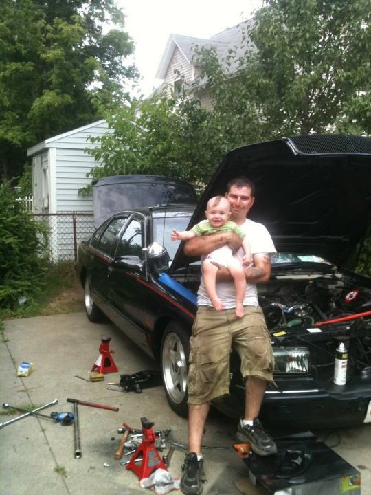

...progress and such...still moving forward... Under the hood is in a million pieces. Inner fenders are coming out tm. still looking for 1 seat, drivers door panel, picked up a 3rd bumper to "mod". Tail light harness replaced, 91/92 tails are now useless to me for now. Swapped on a minty set of 93-96 tails for now. Added a brand new fuel bib. New out of the box fuel rail covers/studs and quick disconnect tool too install them the right way. Got a new drivers arm rest for $3. Buick rear brace, some cleaning, sand blasting, and painting coming up. Another grill in the works. SS door spears painted and installed(BIG PITA). Spotlights are gonna be painted black. New water pump painted and installed. Alternator painted. AIR deleted. Need to reprogram the computer and remove the pita pipe. Need to install courtesy lamp harness. Cadillac horns to install. Console shift needs to be adjusted somehow, doesnt always bring the column back to park. I have to turn it myself to get the key out. And some other stuff I've forgotten about. I'm willing to bet she won't be on the road the rest of the year as well as no inspection sticker. Need to replace entire air dam also. Got lots more parts to throw at it in the next couple months. I need a new floor jack...

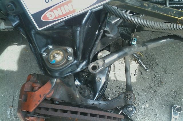

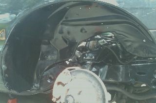

I picked up the (2) 3/4-16 drain plugs to cap the manifolds. About $8 at Advance. Here's some pics from today. Took alot apart. Gotta love rust free California!!!! The AIR system came apart piece by piece. Even the manifold pieces separated with zero trouble. No heat, no cutting!!!!! So far Ive got ALOT of vacuum lines to replace and the shock top nut just spins the cylinder around SMH.
Here you can see the destroyed bump stop.
Either the sway bar or tire turned is rubbing here.
Here you can see where the tire rubs inside the inner fender.

PostSubject: Re: The SSheriff (1996 9C1)   Fri Jul 13, 2012 11:14 am
Ive subscribed to doing one side of the car at a time. So far the passengers side is of to a great start. I pulled the inner fender, used a wire wheel on it cleaned it, cleaned it again, and laid about 5 coats of rustoleum. I alos attempted to fill some holes left by the police equipment. Came out good if you ask me. I also did the battery tray and the front outside of the frame so far.

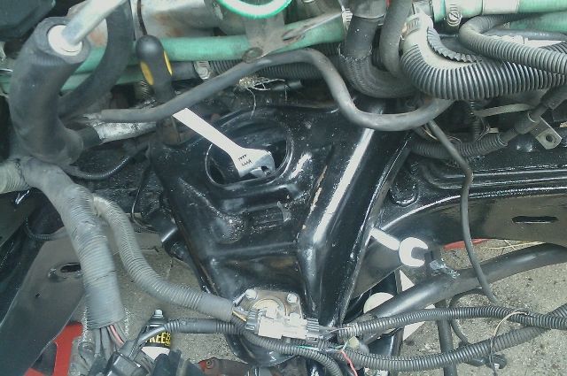

I also got the top shock nut out. 3/4" drill bit and a big flat head and hammer work good and quick. the deep well and extension method didn't work for me. While I was there, I removed the stock destroyed rubber bump stop.

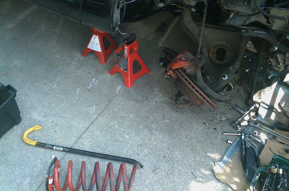

Today I removed the spring without a hitch. I undid the castle nut to the UBJ,outer tie rod, and removed the end link which helped out immensely. Dont forget to unbolt the sensor for safekeeping.

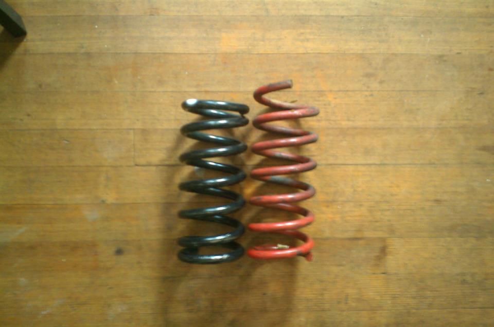

Heres the old SS spring with 1 whole coil chopped on the right. I dont recommend this method AT ALL. It sure looks badass, but your going to regret driving around like that. These SS springs now have about 100k miles on them. On the left, is the Z28 spring Jim suggested. When I get around to installing it, it shouldn't be too hard as it is a bit shorter sprung. But given the de-rating of the SS spring from coil removal. I anticipate the Z28 springs to sit a bit higher as shown in Jims SS thread. Im anxious to see once they settle if they level out with my ST springs in the back or I'm gonna have to throw in my rear SS springs.
And of course, Ive had a little help along the way. They say little hands are good for the hard to reach spots.

PostSubject: Re: The SSheriff (1996 9C1)   Sun Jul 15, 2012 5:25 pm
I put in a good 4 hours today. I got the new spring, shock, UBJ, and ZQ8 installed on the pass. side today. Also, the inner fender and all its mounting bolts and fender to firewall braces were reinstalled. I'm going to be upgrading my brakes (calipers, flex lines, pads, rotors etc) soon. Any suggestions on kits? I'm interested in Wilwood products. No more than dual piston, the rest would be a waste. Also, front and rear sway bar/bushings suggestions would help along with the extended uppers and lowers CA's for the rear. What was it BMR?? GMHP did an upgrade article not too long ago and i just might go with them. http://www.gmhightechperformance.com/tech/suspension/0911gmhtp_1995_chevy_impala_ss_suspension_upgrades/index.html
Anywho, Heres pics of progress up to the new ride height with the new Moog springs and Belltechs...
Had to rig up this ridiculousness to tighten the top shock nut. Gotta love ratcheting wrenches!
Slowly making my way to the dis-assembly and re-working of the drivers side. then on to the rear of the car.

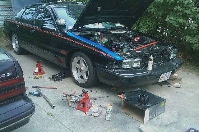

Here's the ride height about 10 min after dropping the car. We'll see in a few weeks if I have to upgrade the rear spring isolators to keep the rake. but the trunk has about 300lbs of tools, parts, and supplies in it for now.
And, my little helper getting dirty with daddy Very Happy
I also installed the Cadillac horns in the pass. side fender. Holes were already there from the factory!

Lisle makes a tool that helps with removing upper shock mount nuts, I forget the number for it, but it comes in handy. I think I got mine online, it's just some hex shaped sockets that fit together, then you slide some ratcheting box end wrenches over the hexes. I just used it on my truck a few weeks ago, but I think I need to break it out again and jack up the suspension with the upper mount loosened to get it fully retightened...
Good to know about the Cadillac horn holes, I plan on getting some, have to take a look at my car...
PostSubject: Re: The SSheriff (1996 9C1)   Sun Jul 15, 2012 6:48 pm
I think you are talking about the tool Jim posted a pic of above, Matt. I don't need a fancy tool like that. I actually like doing these kinda things the hard way now. Gives me more hands on and problem solving I guess.
PostSubject: Re: The SSheriff (1996 9C1)   Sun Jul 15, 2012 6:56 pm
Shock Tool
PEP Boys up here has the tool.
I put a piece of hose on the upper arm just in case the AC lines rub.
Haha, didn't even see that, yes that's the thing I have. You don't HAVE to use it, but it sure does come in handy and isn't a lot of moolah
