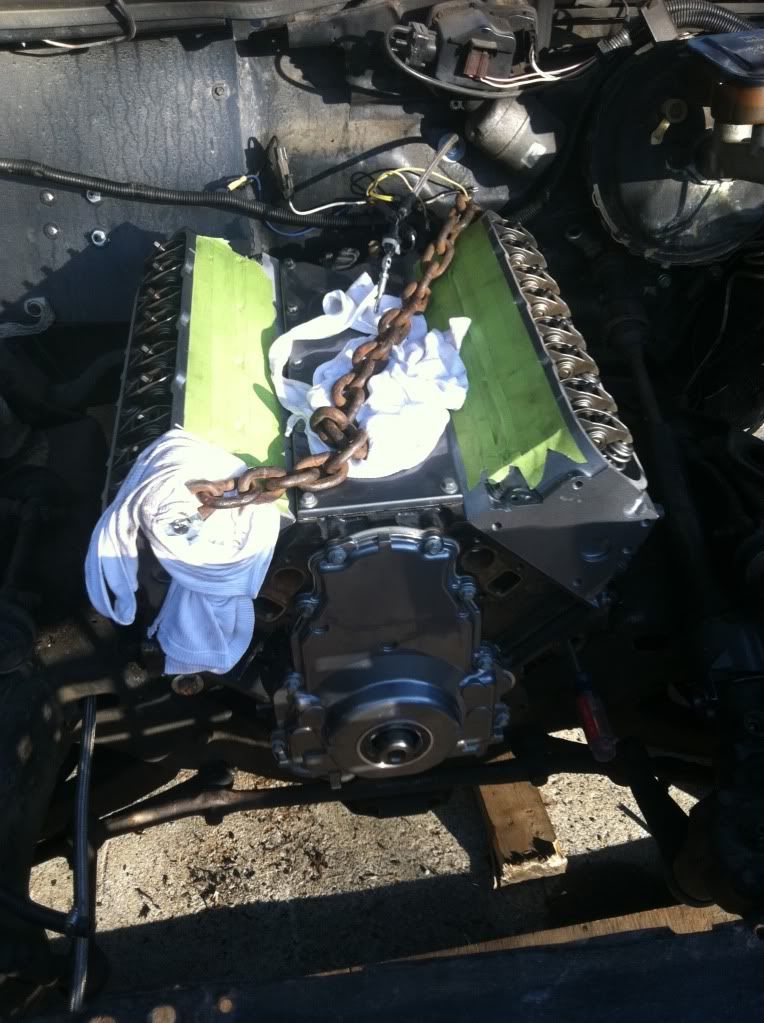

PostSubject: Re: My Build Thread   My Build Thread EmptyMon Mar 19, 2012 6:39 pm
[img]My Build Thread IMG_9389[/img]
PostSubject: Re: My Build Thread   My Build Thread EmptyMon Mar 19, 2012 7:48 pm
Hooray! It happened! Razz
