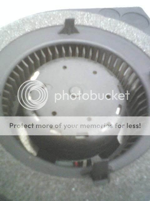

Oh yeah, and Al says he has this thing you can use:
Will that help?
