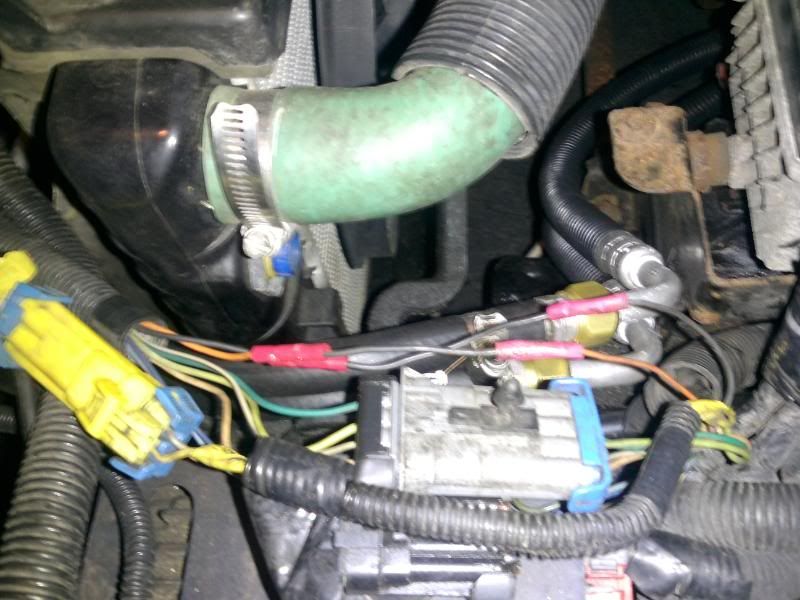

I have them wired in my caprice, and it did not come with them. The harness is there to the connector by the pcm. You just need the harness from the connector to the sockets from a car with cornering lights. Mine works. I will get a pic of the location and wire colors.
The two wires that have butt connectors. The wires were spliced to make them work from another car because the car did not have corner lamps, and since the headlight side of the harness did not have them in the connector, I cut them from the body side of the connector and just used butt connecters to bring them together. So if you get the entire headlight harness, it should be plug and play.

I see you have orange and black on the side of the connector you bypassed going out to the lights. Is that a factory harness section you added or did you get orange/black wiring to make one?
PostSubject: Re: Adding cornering lights to a non-optioned B-body   Mon Nov 08, 2010 7:31 pm
No the car side, it is built into the harness. The wire are there. On the headlight side of the connector, there was no wires for corner lamps, I just added the wire harness of the corner lamps to the existing harness. But if you take the entire headlight harness from a equipped car, it will be plug and play.

PostSubject: Re: Adding cornering lights to a non-optioned B-body   Mon Nov 08, 2010 8:04 pm
Yep, that's what I meant, I knew all the cars came with it built into the harness, lol.
I meant did you make the remainder of the harness for the lights yourself, or snag the rest of it from another car to complete the system? Smile
PostSubject: Re: Adding cornering lights to a non-optioned B-body   Mon Nov 08, 2010 8:07 pm
It was pirated from another car. Wink
PostSubject: Re: Adding cornering lights to a non-optioned B-body   Mon Nov 08, 2010 8:31 pm
Duly noted. If I don't find a harness soon, I'll just ghetto one up with wire. Cool
