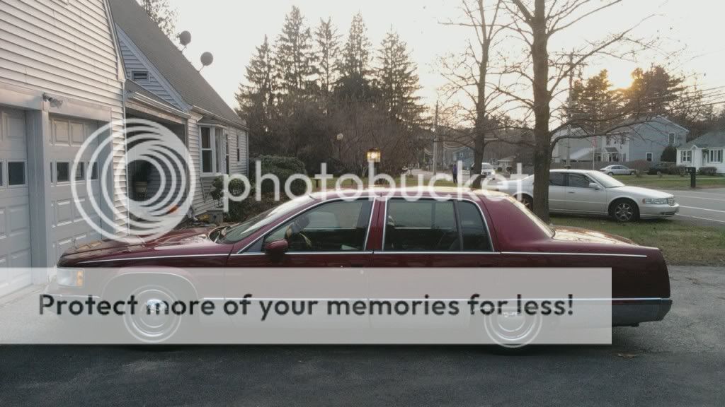

Finally lowered!!!!! Very Happy
One coil cut out of the stock fronts and rear Impala Eibachs with just a little air in the shocks...
Also did new lower balljoints, front Gabriel Ultra HD shocks, and sway bar endlinks. Holy crap! Car actually handles way better and the ride firmed up quite a bit. I really wasn't expecting that while keeping the stock mushy springs! I figured it'd get a "little less mushy" but it went way closer to the "firm" side of the meter. I like it. Smile

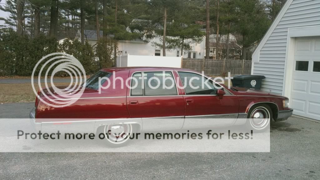

Got a couple dirty side shots this afternoon...
I think I need to let some more air out of the back shocks... Wink
Can't WAIT to do the headers and exhaust! I smoked two of my friends today leaving work. One was a 5.3 01 Silverado 4x4 and the other was an 05 Sportrac Exploder. Hee hee. Smile
And I need to fix the damn traction control switch so I can shut it off!

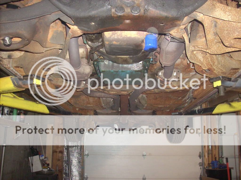

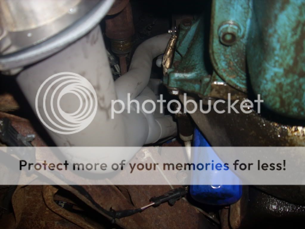

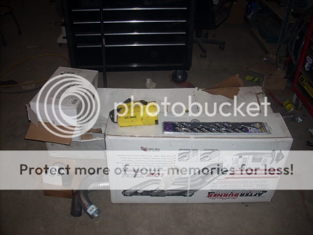

Here's what we started with. A set of uncoated AB's and a Summit mid-70's GM F/S car header-back exhaust, a set of Percy's multi-layered header aluminum gaskets, and a set of ARP 5/16" 12-point head stainless header bolts, and some other miscellany...
"before"
Here's manny's removed:

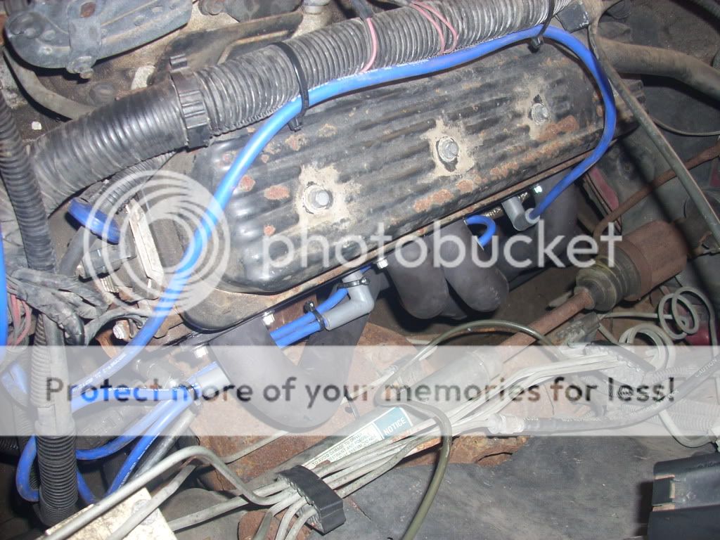

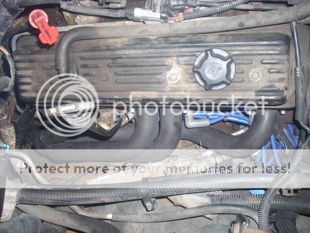

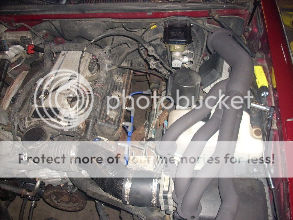

And the headers installed. They clear everything great. Like they were designed for the car, I swear. The passenger side took a lot of extra time to clearance for them. The AC lines are REALLY in the way, but with some carefully aggressive persuading, you can move them to where they need to be without breaking them. And the starter wires and knock sensor wires need to be moved and covered with some heat shielding. You gotta bend the dipstick this way and that way and back this way, but you can get it right without removing it. But anyways, here's the installed pics.
The Thunder Racing Over-The-Cover kit may be in my future, as the wires are pretty close to the headers.

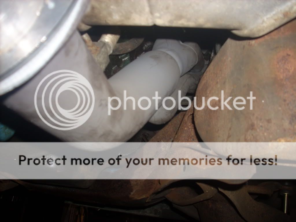

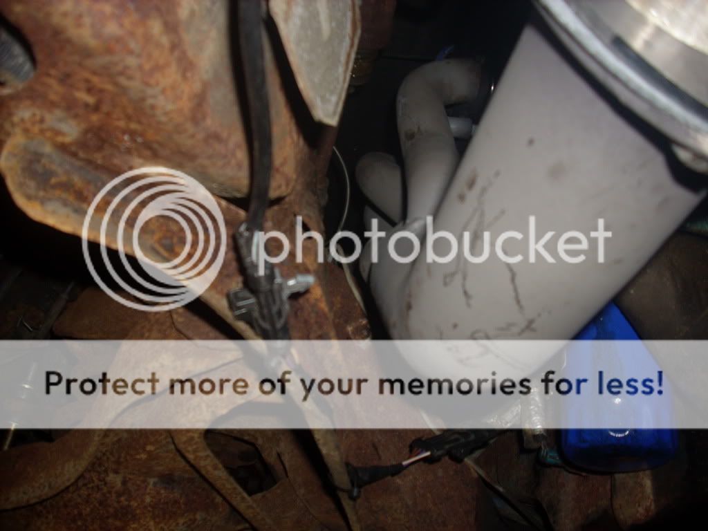

Here's a couple shots of the frame clearance from underneath:
I did have to extend the driver's side o2 wires, but that mostly because whoever installed the replacement oil cooler lines trapped the wiring.

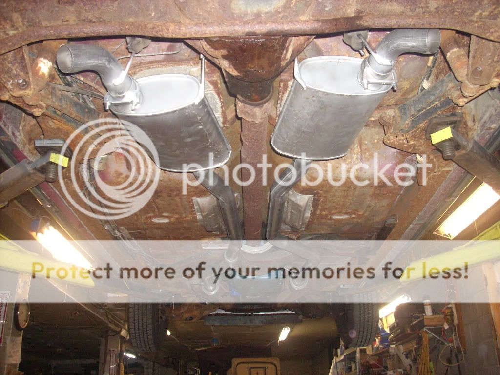

We tried for 3 nights to cut and patch and make that "awesome deal" of an exhaust fit. We couldn't. It didn't. It sucked. Our crossmember phucked us because it's so asymmetrical. We ended up giving up and just drove it to the exhaust shop (open headers, through the middle of downtown Nashua, at like 11pm - AWESOME!) and had him make intermediate pipes and turndowns. We did, however, poke holes in the pipes for the o2's and welded in bungs, so we did have that going for us...
Here's a couple shots of the pipes and turndowns:
It sounds ok-ish. Little lame because of the stock cam. There's a little drone, but not too much. I think I'm going to put tailpipes on it soon as I can afford to... I'll try to get the clip later today.
