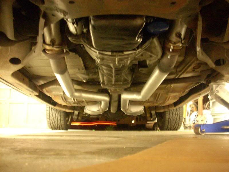

3" Exhaust, pretty! Very Happy
PostSubject: Re: Oil Cooler Lines   Sat Mar 21, 2009 9:48 pm
Well last time I saw it had tiny little cats. Smile
Oh... You mean these?
