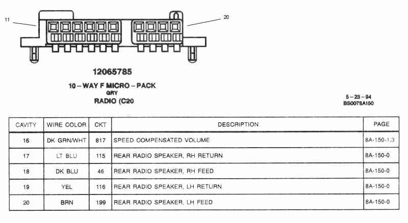

Got a few more things done today. Replaced the oil cooler lines, and gutted the cats. Anyone know how to hook the SCV on the radio so it works.

From what I understand the scv has it's own dedicated wire coming out of the stereo and it ties directly into the vss signal. I may be off though because on some cars I hear it ties into the signal between the pcm and the speedo.
If you can find the scv wire you can try either source and see which one works correctly. Otherwise wait for someone with the fsm to check their diagrams.

Based on the Lenco diagram for the 94-96 Roadmaster there's a "VF-PWM" wire at E4 that's purple/white and ties into the A/C system. Maybe that's it scratch
The '93 diagram shows the same thing but at C4.
I'd guess that's what you're looking for

Scratch that.
From Hack
Speed Compensated Volume - DARK GREEN/WHITE Wire - Pin 16

Scratch that.
From Hack
Got a few things done today Radio_10
I assume that is the plug that goes to the back of the radio. But where does the wire go from there? The VSS?, The PCM?, someplace under the dash?

Most of the times it's disconnected just from getting the wire cut. I'd try to follow the wire from the stock harness and where it ends you'll probably find the other end of the wire just hanging near by. It's not the most technically grand answer, but it's what I would do first. Never like tapping into random wires on a car that has this many electrical signals. If you find the wire has been removed completely then I'm sure someone can pull out an fsm and trace the wire coming from the stereo at pin 16.

I am not sure the 95 b-bodys ever had the option, so I am almost 100% sure there is no wire for it. There may be a slot on the connector, but no wire.

I'm pretty sure the 95's had that option. I know my 95 had a few extra wires in the stereo harness that I didn't use when I put in the aftermarket stereo. Never had the stock stereo so I don't know if it was hooked up or not.

connector C200 cavity D8 drk grn/wht crk 817 VSS
