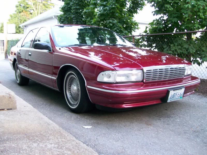

PostSubject: Re: Just dropping the front an inch or two?   Fri Mar 13, 2009 9:15 pm
Here is my Caprice with hotchkis springs and stock wheels. It gave a nice rake, which i wasn't looking for. I have more pictures, I just can't find them at the moment.

PostSubject: Re: Just dropping the front an inch or two?   Fri Mar 13, 2009 11:12 pm
waynes91 wrote:
btw my caprice always seemed to have a low front rake to it,never thought much of it until i got got the 17" 55 series tires on it, then i noticed the air dam would scrap my dirt driveway, driveway is at a good angle to the sideway,took a shovel to that (i rent so i cant do to much)i was going to drop it 2" until i seen how much clearance i had with the stillen front bumper to the sidewalk ,which i couldnt slide my hand between the 2, yeah its that close,if i went with 45 series tires, it would of never worked.. so im guess im saying is think about the areas u drive around in etc
Look at this rake with stock suspension. My old 91 I had a few months back.
PostSubject: Re: Just dropping the front an inch or two?   Sat Mar 14, 2009 8:07 am
With any lowered car you have to be more aware of your surroundings and be more careful pulling into driveways and parking lots and over speed bumps... Small trade-off AFAIC. Smile I think any lower than 2" from stock SS height will be tough to drive around on, as you will find most shallow inclines to be "too steep." Lower than that, go with air. Smile

PostSubject: Re: Just dropping the front an inch or two?   Sat Mar 14, 2009 8:58 am
yep gastt ,the same,nice memory , the same color as mine was b4 i painted it dcm
