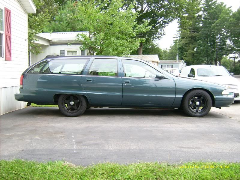

After seeing Als car lowered, I decided to get off my ass, and set mine up with the rake I wanted. I took the stock uncut set of 9C1 springs that Mark Ross had given me, and cut one coil+2" out of it, then sanded and painted them before install.
I will get an alignment tomorrow, and be good to go until I can get another steering box with less play. scratch

Before:
Dropped the nose a bit DSCI0094
After:
Dropped the nose a bit DSCI0170

PostSubject: Re: Dropped the nose a bit   Dropped the nose a bit EmptyWed Aug 18, 2010 5:22 pm
That looks much better!
(but cut another 1/2 coil!) Very Happy

PostSubject: Re: Dropped the nose a bit   Dropped the nose a bit EmptyWed Aug 18, 2010 5:44 pm
that does look pretty nice.
How does it ride with the cut springs?

I rides the same same as stock. Arrow

PostSubject: Re: Dropped the nose a bit   Dropped the nose a bit EmptyWed Aug 18, 2010 6:22 pm
Look great man, I really like it!

PostSubject: Re: Dropped the nose a bit   Dropped the nose a bit EmptyWed Aug 18, 2010 8:33 pm
looks good
but... it would look better like this.. Laughing Laughing

PostSubject: Re: Dropped the nose a bit   Dropped the nose a bit EmptyWed Aug 18, 2010 9:56 pm
Looks awesome! I'd go lower, but who am i to talk. I have one half lowered and the srings for the other buried in the basement

PostSubject: Re: Dropped the nose a bit   Dropped the nose a bit EmptyWed Aug 18, 2010 10:51 pm
I might go lower. After seeing the photoshop of it, I feel I did not go far enough. That pic ruined my glory. Like a Star @ heaven

PostSubject: Re: Dropped the nose a bit   Dropped the nose a bit EmptyThu Aug 19, 2010 7:37 am
Much better, but i'd go lower too Razz Give it a bit, might settle a little more.

PostSubject: Re: Dropped the nose a bit   Dropped the nose a bit EmptyTue Aug 31, 2010 9:00 pm
The front wagon springs are the same as the impala SS springs, so if you only cut 2" of a coil, you are probably still taller than stock. I have 9C1 springs with one full coil cut off and love it. Stock wheels are even with the top of the fender lip... yet I still have room for 235/75R15 snow tires in the winter!
If I were to do it again, though, I would only cut off 3/4 coil.

PostSubject: Re: Dropped the nose a bit   Dropped the nose a bit EmptyTue Aug 31, 2010 10:40 pm
The car has settled now, and the tire is even with the lip. It looks awesome. cheers
And the frame is resting on the ZQ8 bump stops. Arrow

PostSubject: Re: Dropped the nose a bit   Dropped the nose a bit EmptyTue Aug 31, 2010 10:46 pm
You should probably trim them bumpstops then eh?

PostSubject: Re: Dropped the nose a bit   Dropped the nose a bit EmptyTue Aug 31, 2010 10:59 pm
That is what the rust on the frame is doing. Razz
