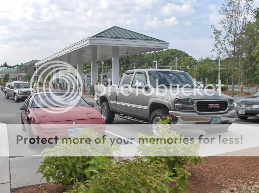

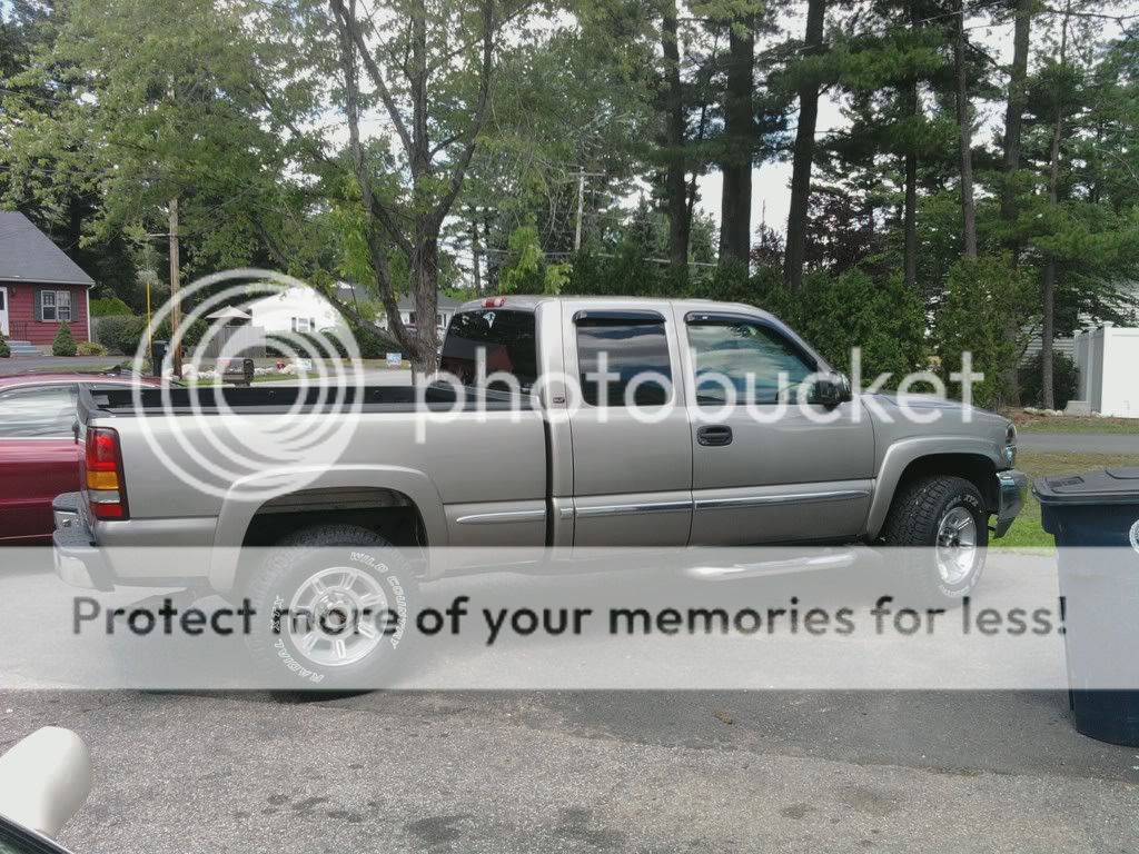

Here they are before I swapped out the step bars for full length ones.
And a butt shot... lol

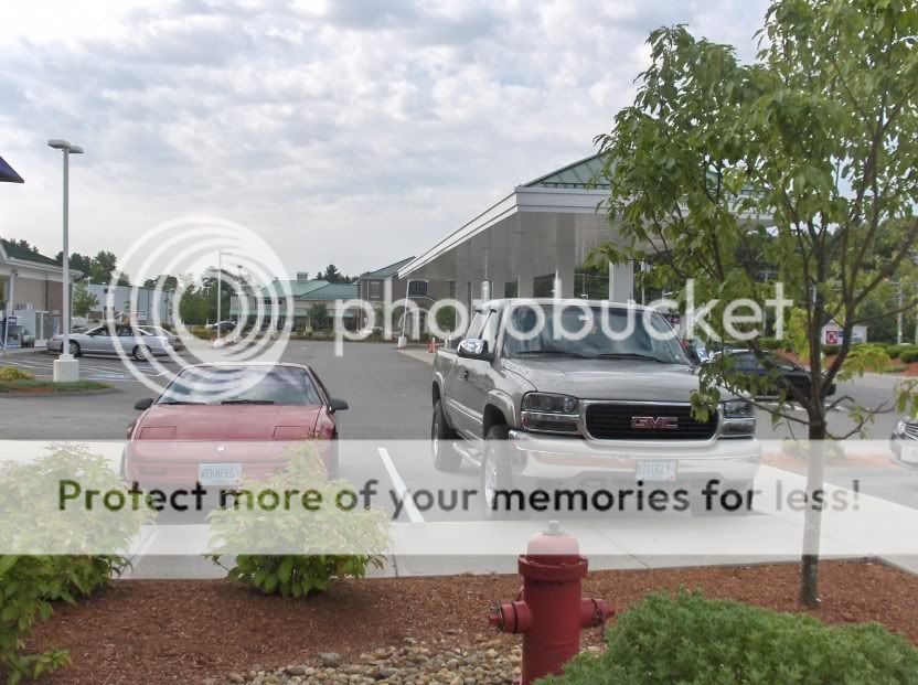

Went to breakfast with my mom and stepdad this morning and he happened to bring his project fiero out. Man that thing looks TINY beside my truck!!!!
Only had to trim the fender lips a little bit...
It actually still only have MAYBE 1/4" clearance on the firewall side of the wheelwell at full lock, but I don't think it's rubbed there yet. Most of the rubbing was on the front.
I also had to modify my stock centercaps a little to reuse them. They have plastic caps that thread onto the lugnuts to hold them on so I figured it'd work easy, but no such luck. The caps have 4 little stand-offs on the base of them that set on the lug face. They kept them from fitting on the H2's because the lug faces are recessed on those rims a bit, so I just had to trim a lil bit more than 1/6" off the standoffs and they fit fine. No biggie. Dremel sure did come in handy for this rim swap! Very Happy
So apparently, you CAN fit 33's on a 2500 non-HD, with just a little trimming and a torsion bar crank. Although, I think I only have one more crank until they are maxed out...
