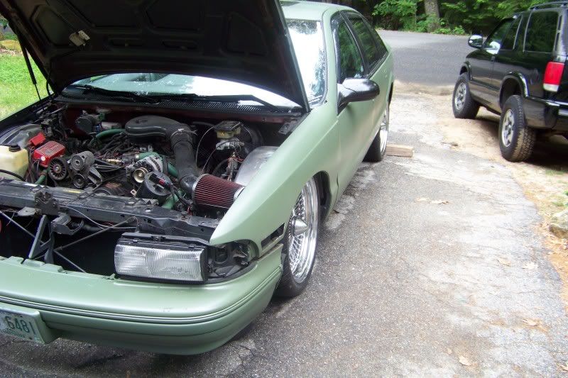

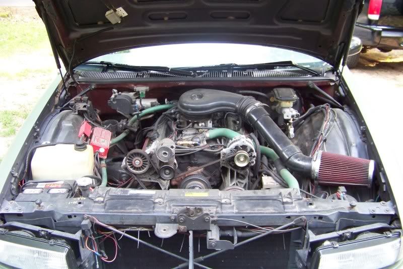

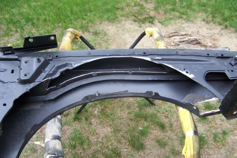

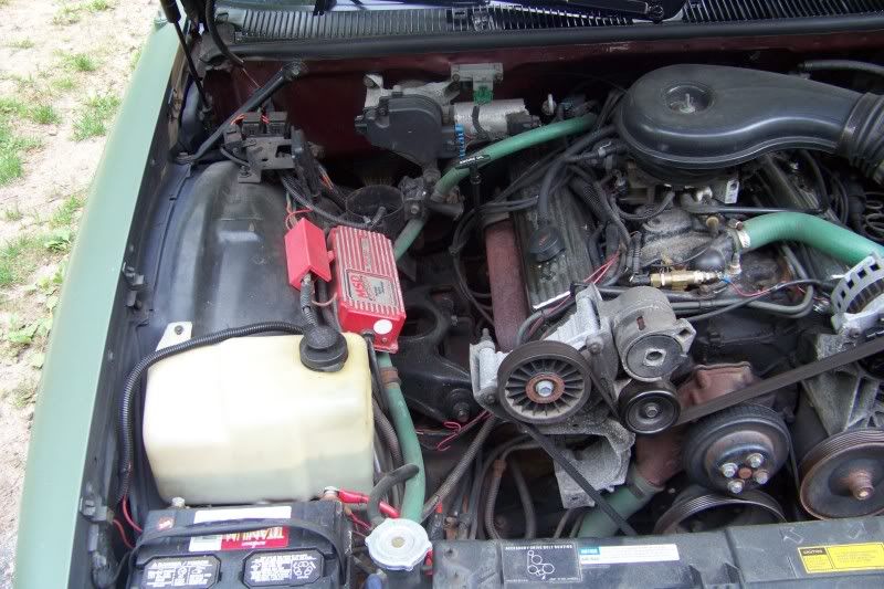

when i put the 20s on the tires would sit against the inner wheel wells
when aired out.
ive always liked the look of smooth trailer fenders.
so heres my quest to make some room.
a couple of shots before the work begins.
made a little room. 100_4563
made a little room. 100_4564
made a little room. 100_4565
what a cute couple...
made a little room. 100_4576

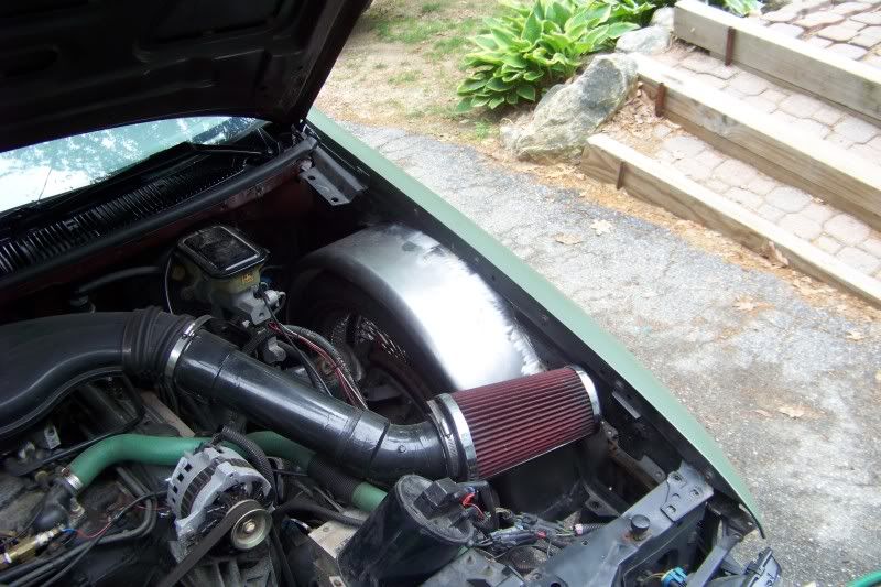

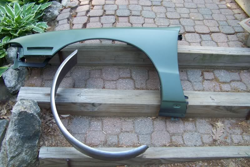

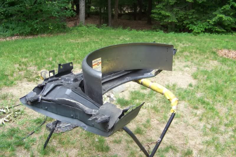

mark and trim, fit pretty good after the first cut.
made a little room. 100_4580
made a little room. 100_4582
made a little room. 100_4584

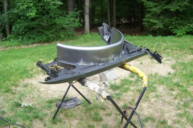

tacked it in a few places and test fit for clearance.
made a little room. 100_4587
made a little room. 100_4588
made a little room. 100_4589
both sides done.
made a little room. 100_4596

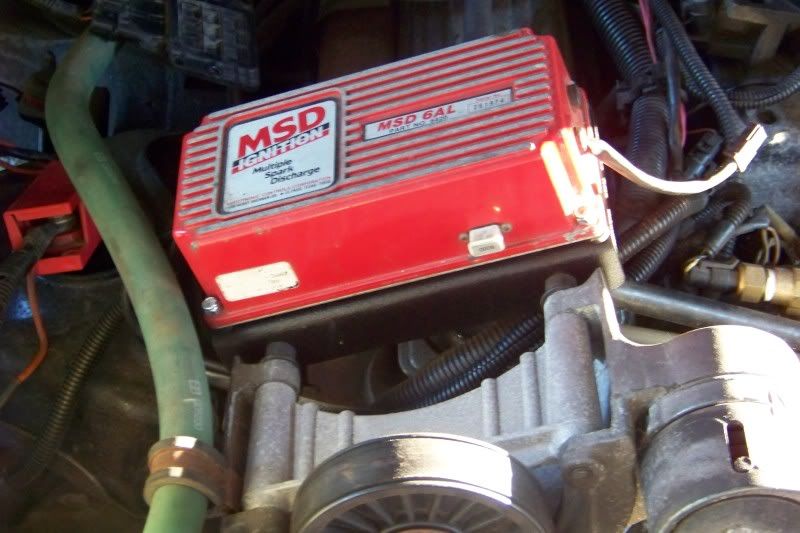

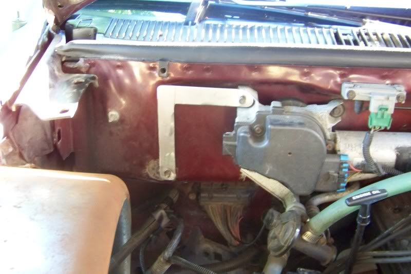

bracket i had to make to mount the msd.
will have to be redone when i install the a/c.
made a little room. 100_4597
made a little room. 100_4598
had to make another bracket for the rest of the stuff.
made a little room. 100_4602

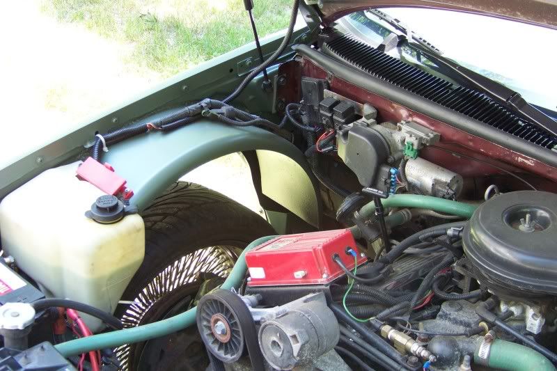

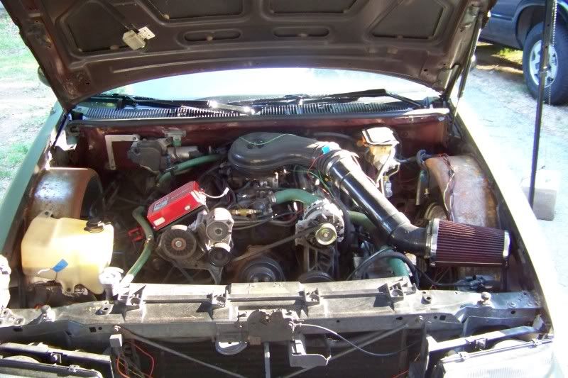

a good shot of the pass. side all back together.
still need to drill one hole and then paint the firewall brckt.
made a little room. 100_4781

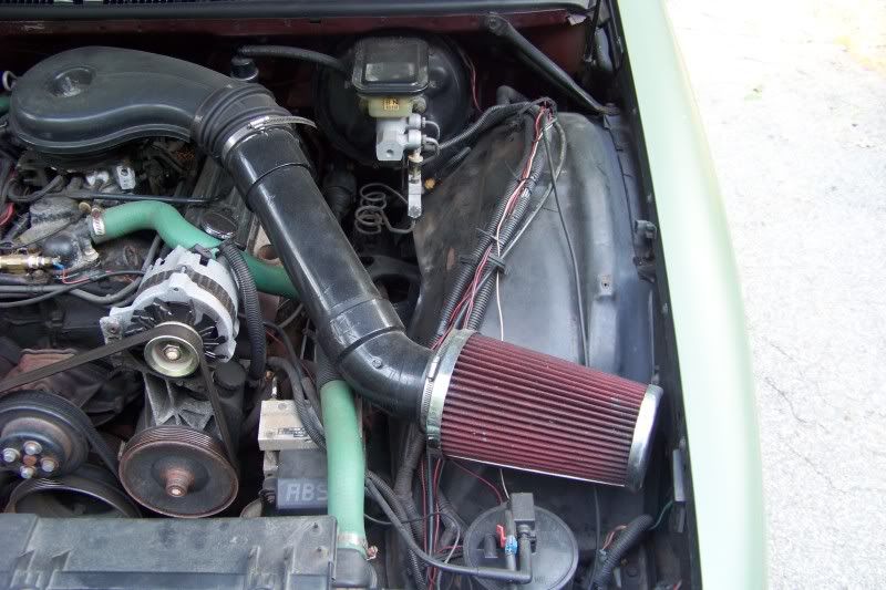

99% done, for now.
over the winter im going to lengthen all the wires on both sides
and they will go inside the fenders for a nice clean look.
made a little room. 100_4779
