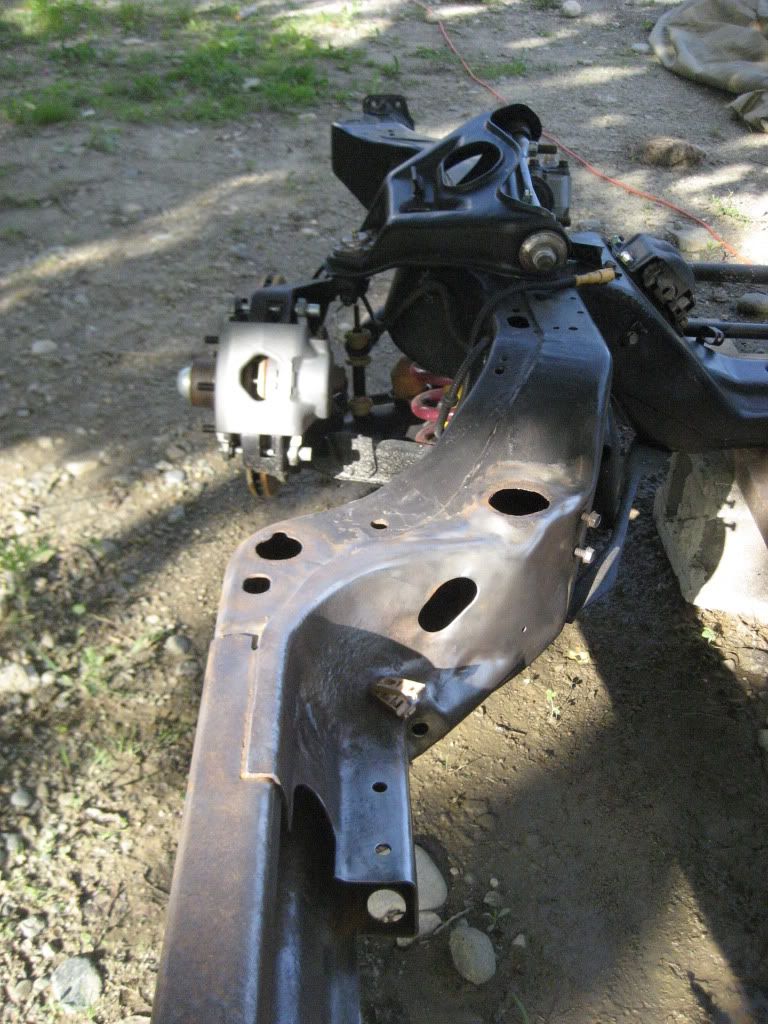

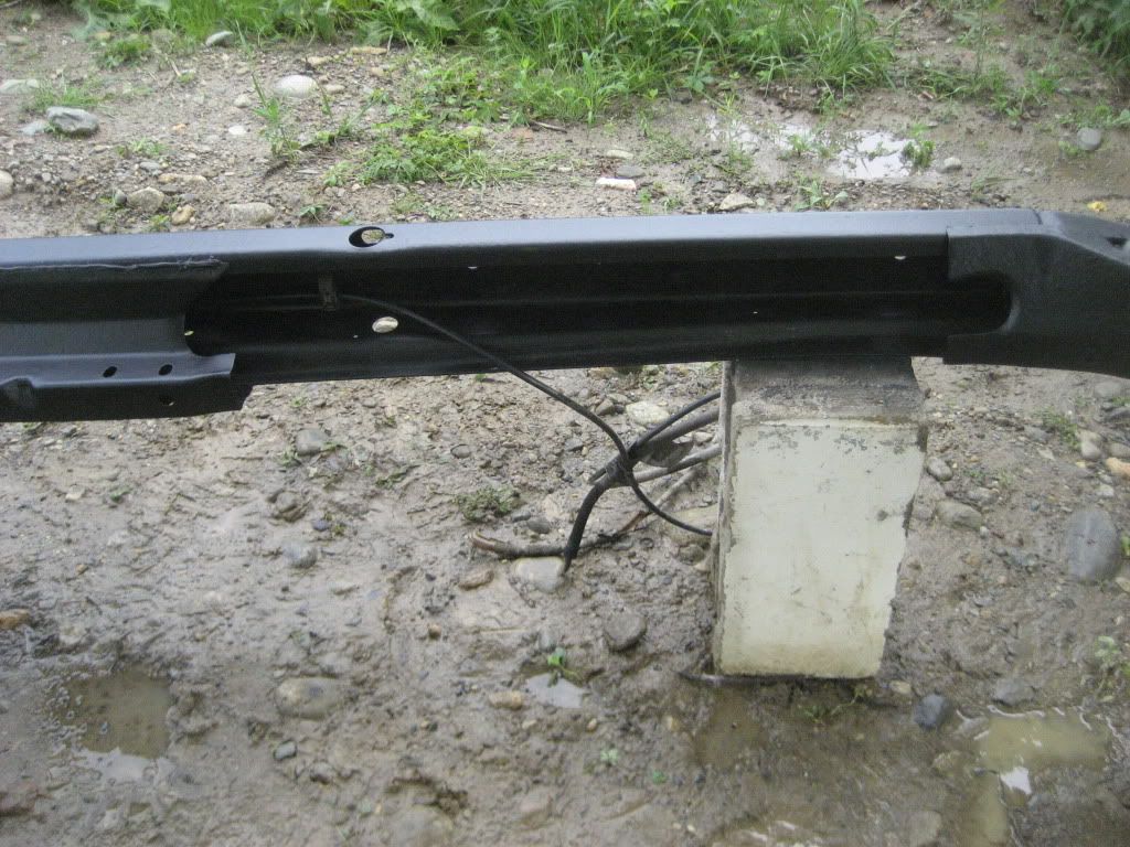

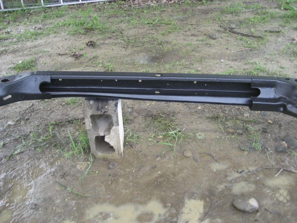

Here's Pictures of the c rails for Jim.
Drivers side is pretty flimsy.Passenger not as bad.
RUH ROH SHAGGY  #@* We might have gone too far this time. - Page 2 Framepor15008
RUH ROH SHAGGY  #@* We might have gone too far this time. - Page 2 Framepor15007

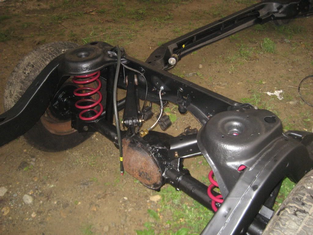

We got the rear installed today.
Couple of minor snags.1 elongated lower arm mount.
Couldn't find the brand new bolts.I bought 3 months ago'
Got a feeling that wont be the last time i can't find something.
Got a newly painted stock cover to install.
Starting to feel like i'm getting something done.
We'll see how i feel in a couple of weeks when it's time to do some of the
more technical stuff.Engine/ trani/ front clip etc.etc.

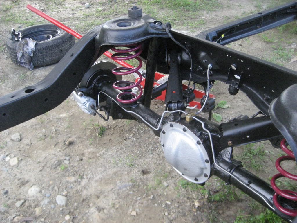

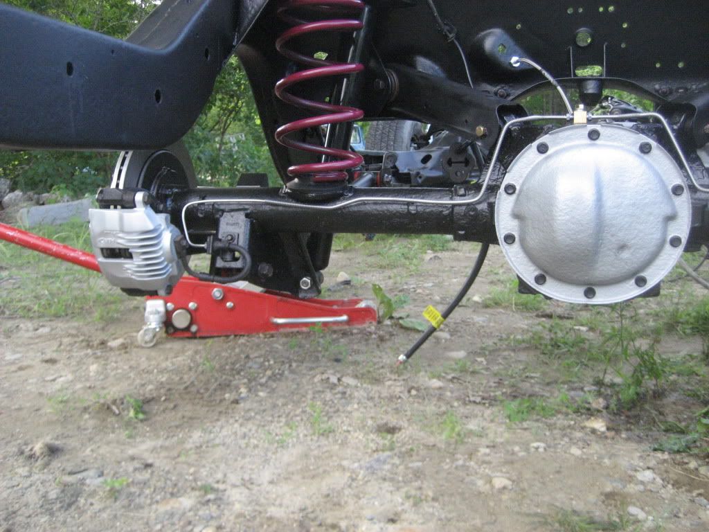

How's this for timing.
Freshly painted cover/New Fluids/Brake lines/Painted calipers/New rotors.
Looking a little better with each picture.

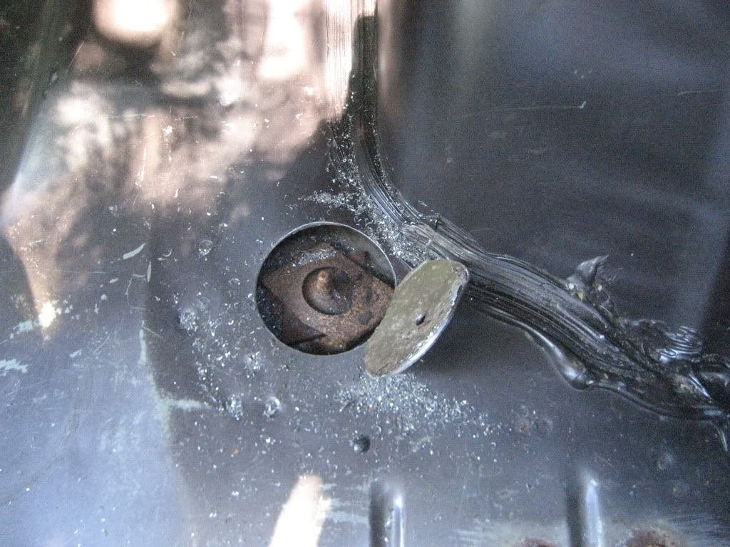

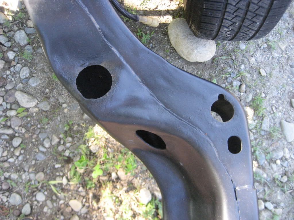

Thought you guys might like to see a couple of things that you might run into when replacing body mounts.
First the #1 mount was rusted so out bad the rubber falls thru on the drivers side.
The hole on the left should look like the one on the right.
This is caused by the water running down the frame and firewall directly into this area.
Sadly i've been working on the frame for a month
and didn't realize till i test fit the new mounts that we're gonna have to fab a peice to fill it in.
RUH ROH SHAGGY  #@* We might have gone too far this time. - Page 2 Rearendrehab013
This is the #6 mount right behind the rear wheels.
These are the only bolts that broke off when removing the body mounts.
I had tryed to remove the stubs with the fire wrench and only managed to SEAR the inside of my arm.
Thinking about getting 9C1 tattooed right in the middle of the burned area.
The car will be on the road before the burn heals up.
We used a hole saw to access the upper bolt/will replace with a big washer bolt setup.
I'LL weld up the hole later.
RUH ROH SHAGGY  #@* We might have gone too far this time. - Page 2 Rearendrehab016

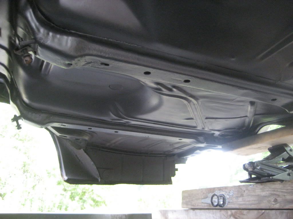

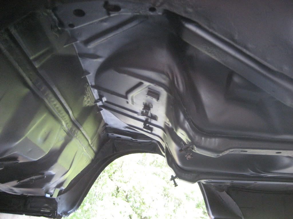

Couple of underbody Pics.
POR-15ed and 4 cans of semi Flat.
Engine/trani install and Body back on next weekend. cheers

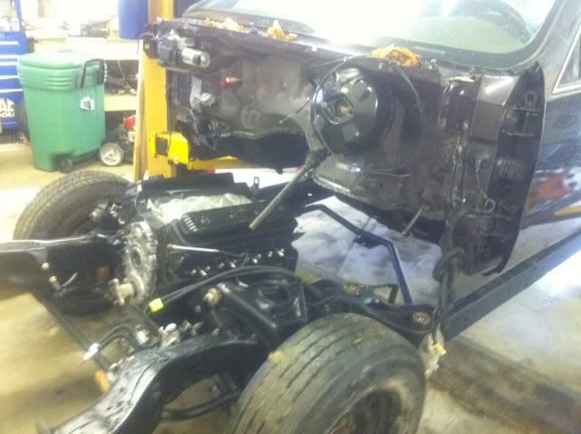

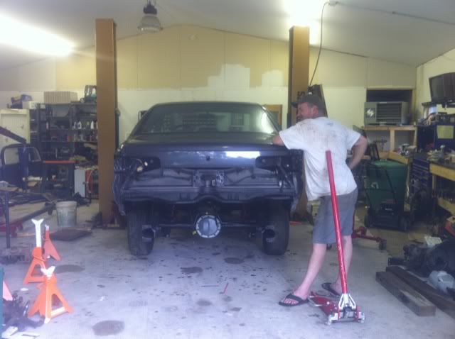

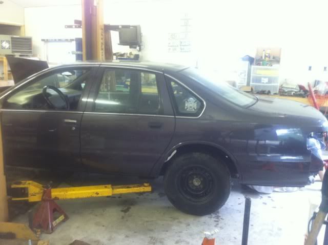

A few pics from today.
Not the greatest pictures.but a huge day overall.
The beast almost resembles a CAR again.
Won't be long now.Time to start putting it back together. Laughing
Me holding down the back corner.we only had it resting on 3
arms of the lift.
RUH ROH SHAGGY  #@* We might have gone too far this time. - Page 2 Photo_4
Sounds scary but it got the job done.
Everything lined up on the first drop !!!!!!!
I know Glenn was as surprised as i was that it didn't take a couple of tries to get it right !!!!!!!!
RUH ROH SHAGGY  #@* We might have gone too far this time. - Page 2 Phot-1
Engine mounted. Waiting on the convertor. My fault. I waited till the last minute to order it .Hopefuly it'll be here monday
RUH ROH SHAGGY  #@* We might have gone too far this time. - Page 2 Photo_1
The underbody looking better than the topside.
Paints gonna have to wait till next year. Shocked
RUH ROH SHAGGY  #@* We might have gone too far this time. - Page 2 Photo_5

Haven't taken many pics.but here's a few.
New fuel pump/refurbed sending unit .
Powdercoated retaining ring. Shocked
RUH ROH SHAGGY  #@* We might have gone too far this time. - Page 2 BLOWNMUFFLERJULY7TH023
Tank installed with New Powdercoated Tank straps and Filler neck.
RUH ROH SHAGGY  #@* We might have gone too far this time. - Page 2 BLOWNMUFFLERJULY7TH042
RUH ROH SHAGGY  #@* We might have gone too far this time. - Page 2 BLOWNMUFFLERJULY7TH038
RUH ROH SHAGGY  #@* We might have gone too far this time. - Page 2 BLOWNMUFFLERJULY7TH040

Here's a picture of my buddy Glenn bringing the beast home from Bath ME.
The job would have never got done right without him.
I still gotta be nice to him/Need more parts. Shocked
